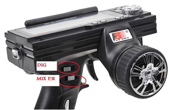

    Voici la config de la radio a utiliser
    enter-REV-long enter-scroll to d-scroll to ch3-enter-MOM (or your choice of switch type)-enter-NOR-enter-NPV-long enter
    then
    enter-REV-long enter-scroll to 3-enter-scroll to ch3-enter-NOL (or your choice other than MOM)-enter- scroll to 5-30 (depending on how many steps you want)-enter-NOR-enter-NOO-long enter-end
