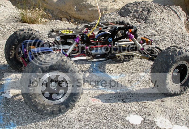

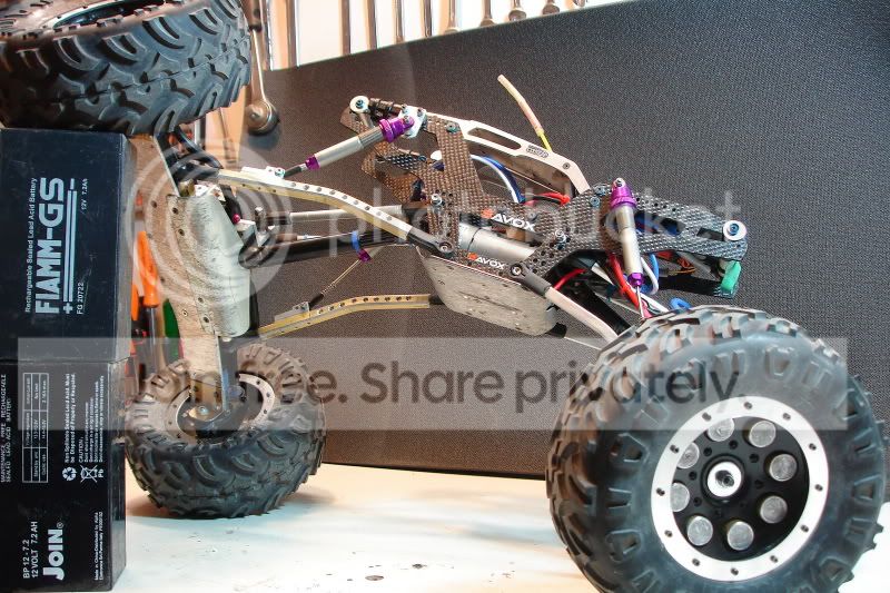

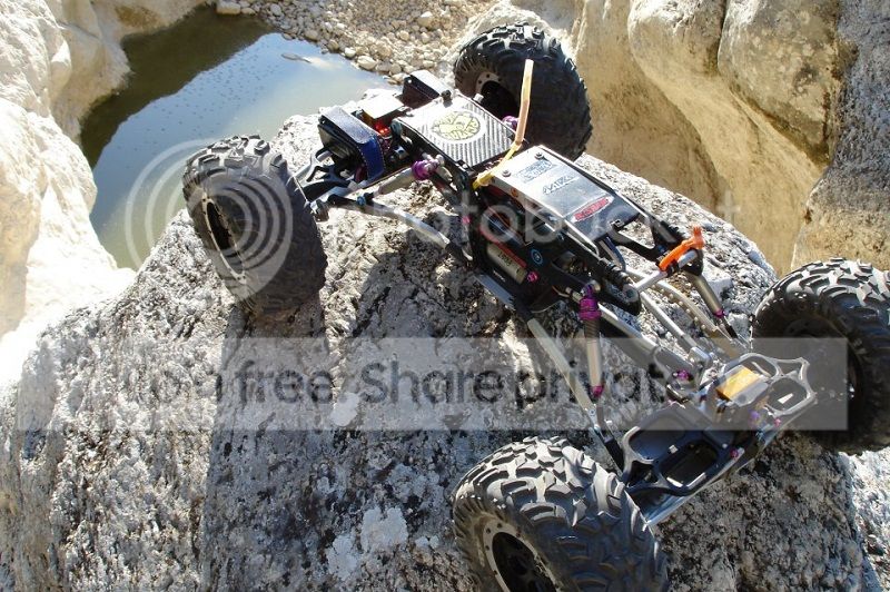

    GRAVITY
    Truck: carbon-kewlar fiber + Alu
    differential and axles E-Maxx
    two motors 600 - gearbox 18:1
    two esc Robitronic speedstar2
    two high-torque servo Savox
    TX Futaba FF9
    diff body clearance 85 mm
    center chassis clearance 110 mm
    total weight 5,64 Kg
    wheelbase 460 mm
    total width 440 mm
